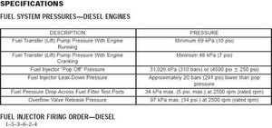

    he most common mechanical failure of the VP44 pump is rupturing of the diaphragm in the front of the injection pump. The diaphragm ruptures allowing the timing piston to vibrate and damage the front cover until fuel bypasses. This will cause the dreaded check engine trouble code P0216. When this occurs your Bosch VP44 Injection Pump must be replaced. The rupturing of the diaphragm is caused by a poorly designed lift pump. When the lift pump does not supply the Injection pump with the correct amount of Fuel Pressure (a minimum of 5psi under load at wide open throttle) the diaphragm then doesn't have enough positive pressure and ruptures. Dodge has recognized this problem as they will no longer even sell the lift pump that goes on the side of the block, they replace it with a unit that is now mounted in the tank. The average cost of having the lift pump put in the tank is about $800.
    The next most common mechanical failure of the VP44 is that the rotor seizes in the head of the pump. This again can be contributed to the lift pump not providing enough fuel to the injection pump. Diesel Fuel is used as a lubricant , so when there is a insufficient amount of fuel the rotor does not get lubricated properly. If the rotor seizes the truck wont start and the VP44 Injection Pump must be replaced.
    Fuel Pressure Specification For Bosch VP44 Injection Pumps
    http://articles.mopar1973man.com/2n...-specification-for-bosch-vp44-injection-pumps
    Fuel pressure
    Normal fuel pressure should float about 14-15 PSI running down the pavement. It should never fail below 10 PSI at all. Here is a colorize fuel pressure gauge to give you a clue of the fuel pressure span you want. You want the needle to stay in the green at all times. Yellow zone is a warning that you should check the fuel filter, lift pump performance, overflow valve, etc.
    This is undocumented maximum pressure is 20 PSI
    I would personally suggest you adjust your minimum pressure to 14 PSI this will ensure the overflow valve remain open and a constant fuel flow through the Bosch VP44 injection pump and keep it cool all the time.
