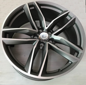

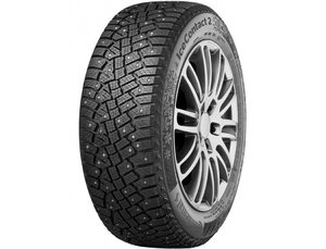

    Continental Ice Contact 2 SUV 265/50 R20 T 111 + диски WSP Italy PENELOPE 8.5xR20 5x112 ET33 DIA66.6
