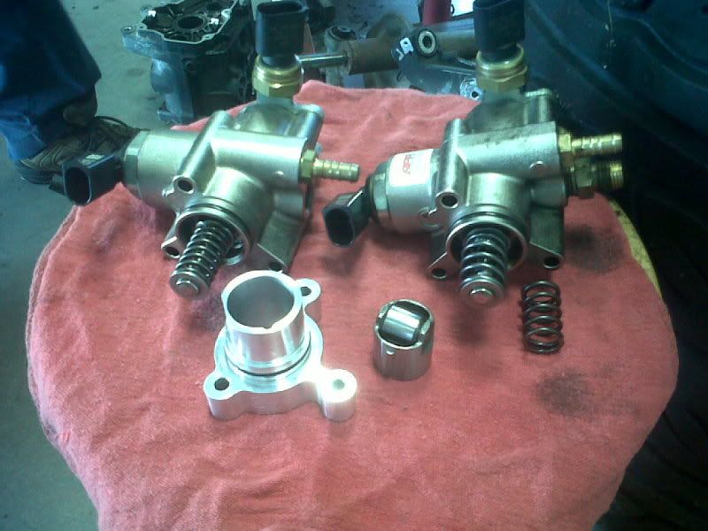

    Мишаня, можно рассматривать данный вопрос, НО только НЕ с родным токателем!!! Сожрет его быстро.
    Как вариант смотреть в сторону новой ревизии от KMD, но ценник на него адский... $ 99 в США без доставки.
    Обратите внимание на юбку основания...
    [CUT]After months of R&D KMD Tuning is pleased to present another product to their 2.0T FSI line up. Typically customers don’t pay mind to their cam follower and as you all know, the factory cam follower can cause fuel cuts when worn down. Additionally, from their experience and testing, when using an after market fuel pump the cam follower can wear down even quicker then normal.
    With that in mind KMD designed a follower made from the factory material, hardened to the same spec, and is .028 larger then factory. We also eliminated the factory c-clip (one less thing to fail). The reason we decided to use this specific increase was because after trying larger and smaller sizes this was the most efficient without causing cam wear. At 10k the follower thickness was at .019 and at 20K it was at the factory size, which now gives you an extra 20K and most importantly, piece of mind! This testing was done over a period of 8 months on 4 different vehicles that varied from stock to stg3 500hp cars. When running a stock car the wear on the follower was even less then stg1 vehicle.[/CUT]
    Но и это не выход всегда. Вот такое "счастье" случается на живом впускном валу новой ревизии с ТНВД APR и толкателем VAG... Как бы это прескорбно не было :( Усиленный шток хорошо, но не долговечно...
    А вообще вот интересный вариант нашего мотора ))))))))))))
    Обратите внимание на валы!!!
    SCHRICK Sportscamshaft-Kit/Intake: 246°-Exhaust: 252°
    РУДЫ АЛЕША!!!!!!!!!!!!!!!!!!!!!!!!!!!!!!!!!!!!!!
    ЕБАТЬ!!!!!!!!!!!!!!!!!!!!!!!!!!!!!!!!!!!!
    Найдено решение наших проблем с толкателями!!!!!!!!!!!!!!
    Теперь есть роликовый на наши моторы!!!!!!!!!!!!!!!!!!!!!
    Представляю - H2SPORT Cam Follower upgrade kit
    При этом меняется еще кулачок впускного РВ, но ценник за все счастье - смешной
    H2SPORT FUEL PUMP DRIVE UPGRADE - смотрим
    Вкратце дискуссии и процесс замены ТУТ
    Смотреть внимательно картинки по замене ТУТ - слова лишние.
    Возвращаясь к теме толкателя в оригинале - америкосы в основном юзают VAG или INA
    Мишаня, позакидывай названия и ссылки в шапку.
    P.S. красотища.....

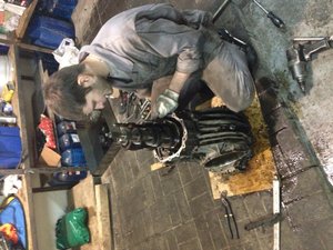

    Какие нах тнвд, крышки , вот тема

  16. Aleksey-81
    Aleksey-81 Живу я здесь
    18 апр 2007
    1.297
    Audi A4/B7 2.0TQ M

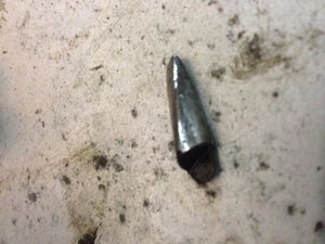

    В дифиринциале нашел, а вот откуда этот зуб хз, кто разбирал коробки, как снять валы ???
      86,6 КБ
      99

    Леша, валы и толкатель с роликом - разные песни!!!!!!
    Валы это уже под St4
    А вот толкатель с роликом + проставка под тнвд + кулачок вала - класс
    Вал не входит!!!! Только его кулачок уменьшенный с правильными углами. Осталось придумать - как кулачок заменить.... В отчете видно, что его греют или охлаждают
