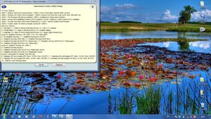

    #278 st.wall, 4 мар 2013
    Чего их искать? Окно типа этого появляется?
      132,7 КБ
      344
  19. st.wall
    st.wall Интересуюсь
    4 мар 2011
    1.800
    A6/C6 2.0TDI 2006
    #279 st.wall, 4 мар 2013
    Вот короткая кодировка http://wiki.ross-tech.com/wiki/index.php/Audi_A6_(4F)_Comfort_System#Coding
    +0000128 = Comfort Function via Remote (NOT PR-B29/B30/B34/B35)
    Не оно???
    И далее
    [Adaptation]
    Channel 061: Comfort Functions
    +001 = Comfort Closing: Window Regulators via Remote Control
    +002 = Comfort Opening: Window Regulators via Remote Control
    +004 = Comfort Closing: Sunroof via Remote Control
    +008 = Comfort Opening: Sunroof via Remote Control
    +016 = Comfort Closing: Window Regulator via Switch Drivers Door
    +032 = Comfort Opening: Window Regulator via Switch Drivers Door
    +064 = Comfort Closing: Sunroof via Switch Drivers Door
    +128 = Comfort Opening: Sunroof via Switch Drivers Door
    +256 = Comfort Closing: Window Regulators via Lock Cylinder
    +512 = Comfort Closing: Sunroof via Lock Cylinder
