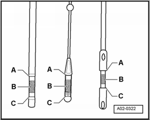

    Вот что пишет завод...
    <table cellpadding="0" cellspacing="0" width="100%"><tbody><tr><td class="spalte-text"><table class="cc abstand-kap einzug-standard"><tbody><tr><td class="titel-kap">Engine: checking oil level</td> </tr> </tbody> </table> Note
    <table class="cc abstand-liste-erster einzug-standard hinweis-rumpf"> <tbody> <tr> <td class="einzug-liste">t </td> <td>Engine oil temperature at least 60 °C.</td> </tr> </tbody> </table> <table class="cc abstand-liste einzug-standard hinweis-rumpf"> <tbody> <tr> <td class="einzug-liste">t </td> <td>Vehicle must be level (horizontal).</td> </tr> </tbody> </table> <table class="cc abstand-liste einzug-standard hinweis-rumpf"> <tbody> <tr> <td class="einzug-liste">t </td> <td>Wait a few minutes after switching off the engine to allow the oil to flow back into the sump.</td> </tr> </tbody> </table> <table class="cc einzug-standard abstand-standard"> <tbody> <tr> <td class="einzug-liste">– </td> <td>Pull out the dipstick, wipe with a clean cloth and insert again as far as it will go.</td> </tr> </tbody> </table> <table class="cc einzug-standard abstand-standard"> <tbody> <tr> <td class="einzug-liste">– </td> <td>Pull out the dipstick again and read off the oil level.</td> </tr> </tbody> </table> </td> <td class="spalte-pfeil">
    </td> <td class="spalte-marg">
    </td> </tr> </tbody> </table> <table cellpadding="0" cellspacing="0" width="100%"> <tbody> <tr> <td class="spalte-text"> <table class="cc einzug-standard abstand-standard"> <tbody> <tr> <td>[​IMG]
    Markings on oil dipstick:</td> </tr> </tbody> </table> <table class="cc abstand-standard erlaeutrg-leg"> <tbody> <tr> <td class="einzug-nummer">a - </td> <td>Do not top up oil.</td> </tr> </tbody> </table> <table class="cc abstand-liste erlaeutrg-leg"> <tbody> <tr> <td class="einzug-nummer">b - </td> <td>Oil can be topped up. The oil level may rise as far as area -a- after topping up.</td> </tr> </tbody> </table> <table class="cc abstand-liste erlaeutrg-leg"> <tbody> <tr> <td class="einzug-nummer">c - </td> <td>Oil must be topped up. The oil level is sufficient if it is somewhere in area -b- (grooved area) after topping up.</td> </tr> </tbody> </table> Note
    <table style="width: 509px; height: 50px;" class="cc abstand-liste-erster einzug-standard hinweis-rumpf"> <tbody> <tr> <td>The oil level must not be above marking -a- on the dipstick.
    Пишут, что Максимум - это "А".
    Если я правильно понял, у тебя меньше. У меня на горячую, как у тебя на холодную, где-то 2/3 зоны "А". Попробуй долить ещё. Если не переливать где-то на 0.5-1 литр выше "А" - катализатор не сломается.
    У тебя мотюль и 504, если я правильно помню, может и не будет жрать его "больше", как у Аэромена...
