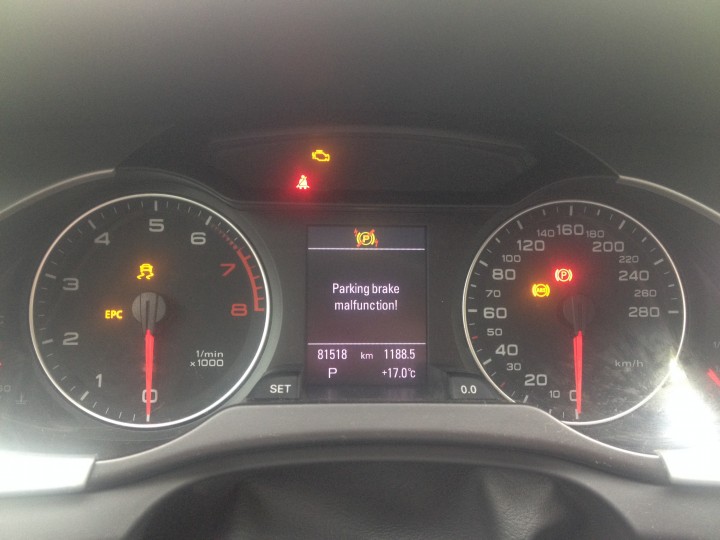

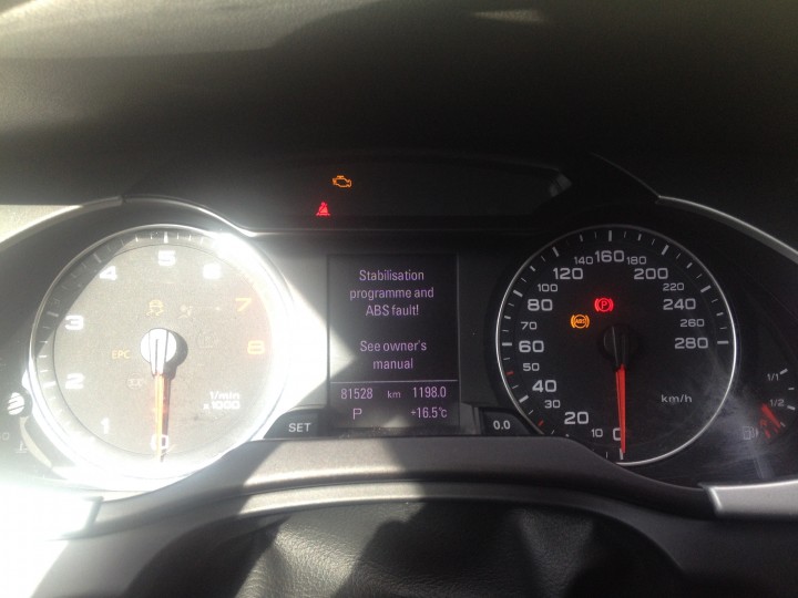

    #28 sergei81, 24 май 2015
    Всем привет.Появились ошибки,что они означают?можно ли обойтись без поездки к официалам?
    Address 03: ABS Brakes (J104) Labels: 8K0-907-379.clb
    Part No SW: 8K0 907 379 BF HW: 8K0 907 379 BF
    Component: ESP8 front H04 0030
    Revision: -------- Serial number: --------------
    Coding: 050500
    Shop #: WSC 06325 000 00000
    VCID: 7EF9E021E9EC549
    2 Faults Found:
    00285 - ABS Wheel Speed Sensor; Front Right (G45)
    012 - Electrical Fault in Circuit - MIL ON
    Freeze Frame:
    Fault Status: 11101100
    Fault Priority: 2
    Fault Frequency: 1
    Reset counter: 152
    Mileage: 81518 km
    Time Indication: 0
    Date: 2015.05.24
    Time: 15:25:16
    Freeze Frame:
    Hex Value: 0x0000
    Hex Value: 0x07A2
    Hex Value: 0x0007
    Hex Value: 0xC099
    Hex Value: 0x00FF
    00473 - Control Module for Elect. Park/Hand Brake (J540)
    013 - Check DTC Memory
    Freeze Frame:
    Fault Status: 01101101
    Fault Priority: 6
    Fault Frequency: 1
    Reset counter: 152
    Mileage: 81518 km
    Time Indication: 0
    Date: 2015.05.24
    Time: 15:25:16
    Freeze Frame:
    Hex Value: 0x0000
    Hex Value: 0x07A2
    Hex Value: 0x002E
    Hex Value: 0x0299
    Hex Value: 0x00FF
    Address 05: Acc/Start Auth. (J393) Labels: 8K0-907-064-05.clb
    Part No SW: 8K0 907 064 CL HW: 8K0 907 064 CL
    Component: BCM2 2.0 H05 0435
    Revision: 00002001
    Coding: 010100
    VCID: 7CFDEA29FFF0469
    Subsystem 1 - Part No SW: 8T0 959 754 HW: 8T0 959 754
    Component: FBSAUDIB8 IDG H60 0072
    Subsystem 2 - Part No SW: 8K0 905 852 D HW: 8K0 905 852 D
    Component: J764 ELV MLB H37 0042
    1 Fault Found:
    02823 - Requirements for Locking the Steering Column Lock not met
    000 - -
    Freeze Frame:
    Fault Status: 01100000
    Fault Priority: 5
    Fault Frequency: 1
    Reset counter: 152
    Mileage: 81524 km
    Time Indication: 0
    Date: 2015.05.24
    Time: 17:00:17
    Address 16: Steering wheel (J527) Labels: 8K0-953-568.clb
    Part No SW: 8K0 953 568 F HW: 8K0 953 568 F
    Component: Lenks.Modul H17 0014
    Revision: -------- Serial number: 90372KA6000LS
    Coding: 000012
    VCID: 3D7B272DA46A8F1
    Component: E221 - MFL H02 0010
    1 Fault Found:
    01316 - ABS Control Module
    Freeze Frame:
    Fault Priority: 6
    Fault Frequency: 10
    Reset counter: 152
    Mileage: 81518 km
    Time Indication: 0
    Date: 2015.05.24
    Time: 15:26:15
    Address 53: Parking Brake (J540) Labels: 8K0-907-801.clb
    Part No SW: 8K0 907 801 H HW: 8K0 907 801 H
    Component: EPB Audi B8 H09 0100
    Revision: 00000003 Serial number: 10000000704234
    Shop #: WSC 00000 000 00000
    VCID: 346D020997204E9
    3 Faults Found:
    02427 - Brake Disk Right Rear; Not Reached
    000 - - - Intermittent
    Freeze Frame:
    Fault Status: 00100000
    Fault Priority: 1
    Fault Frequency: 1
    Reset counter: 192
    Mileage: 81524 km
    Time Indication: 0
    Date: 2015.05.24
    Time: 16:58:37
    Freeze Frame:
    Voltage: 12.50 V
    Count: 1
    Speed: 0.0 km/h
    Hex Value: 0x0270
    Hex Value: 0x0008
    Hex Value: 0x1008
    013 - Check DTC Memory - MIL ON
    Freeze Frame:
    Fault Status: 11101101
    Fault Priority: 4
    Fault Frequency: 1
    Reset counter: 152
    Mileage: 81518 km
    Time Indication: 0
    Date: 2015.05.24
    Time: 15:27:01
    Freeze Frame:
    Voltage: 12.30 V
    Count: 62
    Speed: 0.0 km/h
    Hex Value: 0x0273
    Hex Value: 0x0001
    Hex Value: 0x1010
    03199 - Actuator for Electric Parking Brake; Right
    003 - Mechanical Failure - Intermittent
    Freeze Frame:
    Fault Status: 00100011
    Fault Priority: 1
    Fault Frequency: 1
    Reset counter: 192
    Mileage: 81524 km
    Time Indication: 0
    Date: 2015.05.24
    Time: 16:51:21
    Freeze Frame:
    Voltage: 13.20 V
    Count: 5
    Speed: 0.0 km/h
    Hex Value: 0x02F0
    Hex Value: 0x0001
    Hex Value: 0x0208

    Проблема достаточно серьезная - судя по всему вылетели ESP и стояночный тормоз, если не скидываются и не пропадают - лучше к дилеру съездить

    Начни с Датчика абс переднего правого колеса, 90% проблема в нем.

    Плюсую. Поменяй датчик, сбрось шибки ВАГ комом, проведи инициацию стояночного тормоза, а там посмотрим.

    Проблема была в датчике абс,делал у знакомого электрика,провод накинули на левый датчик и ошибка исчезла.
