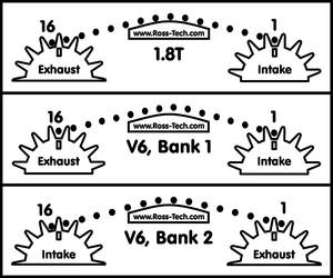

    Possible Symptoms
    Malfunction Indicator Light (MIL) ON
    Possible Causes
    Timing Issue
    Camshaft Adjuster
    Possible Solutions
    Check Setting of Timing Belt
    Check Timing of Intake/Exhaust Cams
    Check Cam Adjusters as per Repair Manual
    Special Notes
    North American Market (NAR) specific notes:
    When found in 2009 Audi A4, A5 or Q5 with 3.2FSI AVE Engines, please see TSB 15-09-04.
    When found in 2008 and newer VW 2.0T engine with a timing chain (example; CCTA and CBFA), please see TSB 15-12-01 or TPI 2028302 for no-start timing chain related problems.
    General notes:
    On engines with chain driven intake camshaft(s), but belt driven exhaust camshaft(s), verify the number of chain roller links between the intake and exhaust camshafts is correct. Click on thumbnail to enlarge:
    не совсем понимаю но косвенно намекают на перескок...
    ошибка P0016
