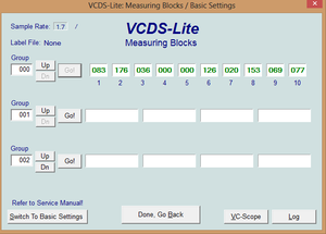

    thank you for YOUR advice! :hi: although i have MS office 2003, i found how to do this. about mmc300 i can't say anything, because i never saw it naturally. by me, mmc100/200 are better, because they are simplier, u can apply mix by yourself by that magic screw. what about mmc200 logs? what's happening with the window 9 in 000 group? the counts there are increasing and decreasing. did you try to move screw during these measurements?
    anyway, i'm waiting for information, that i mentioned in posts above)

    Hello :), sorry for my delay, but there is so much things that i have to do :nod:
    Nope I did not touch anything, values were changing by itself (by the computer) ..... i don`t know why :confused:
    Please check file цък , this is from my short trip yesterday (3-4km) , with SWC 1110, and disconnected lambdas(I wanted to check what will be the consumption ......13.8/100 at the end of the day - urban drive). Today i`ll connect lambdas and set code 1010, later or tomorrow I`ll post results :beer:

    I can`t find out where is the problem, car is not accelerating as good as it should, and when it is at idle I can feel vibration from the engine!
    I checked my sparks for differences between them, but all are normal цък
    Please help, i want to drive 2.8 V6 not 1.8 L4 :cool:
