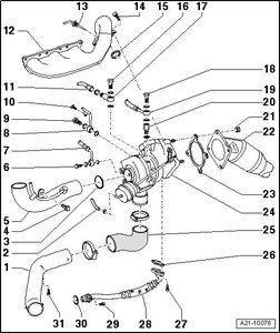

    ткните пожалста пальцем на патрубки идущие к турбинам для охлаждения?

    18,19,20,21 вроде.
    NoteThe diagram shows the turbocharger on cylinder bank 2 (left-side).
    1 - Air pipe
    q To charge air cooler
    2 - Control pipe
    q From charge pressure control solenoid valve -N75-
    3 - O-ring
    q Renew
    4 - Bolt
    q 22 Nm
    5 - Air pipe
    q To air-mass meter -G70-
    6 - Banjo bolt M8
    q 9 Nm
    7 - Pressure line
    q Control pressure supply line
    q To solenoid valve for charge pressure control -N75-
    8 - Coolant pipe
    9 - Banjo bolt M14
    q 35 Nm
    10 - Bolt
    q 10 Nm
    11 - Oil supply pipe
    q From cylinder block
    q Tighten union nut to 30 Nm.
    12 - Exhaust manifold
    q Removing and installing: left-side → Chapter; right-side → Chapter
    13 - Exhaust temperature sender
    q Exhaust temperature sender 1 for bank 2 -G236- (left-side), exhaust temperature sender 1 -G235- (right-side)
    q Removing and installing: left-side → Chapter, right-side → Chapter
    14 - Bolt
    q Renew
    q Coat threads and contact surface of bolt head with high-temperature paste; for high-temperature paste refer to → Electronic parts catalogue
    q 60 Nm
    15 - Seal
    q Renew
    16 - Banjo bolt
    q 30 Nm
    17 - Connection piece
    18 - Banjo bolt
    q 35 Nm
    19 - Coolant pipe
    20 - Threaded connection
    q 35 Nm
    21 - Nut
    q Tightening torque → Chapter
    22 - Front exhaust pipe
    23 - Gasket
    q Renew
    24 - Turbocharger
    25 - Air hose
    q Must be free of oil or grease when installing
    26 - Gasket
    q Renew
    27 - Bolt
    q 10 Nm
    28 - Oil return pipe
    q To sump (top section)
    29 - Bolt
    q 10 Nm
    30 - O-ring
    q Renew
    31 - Bolt
    q 10 Nm
