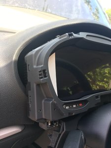

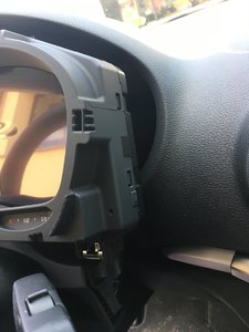

    Hello guys,
    I'm from Germany and I also try to retrofit the Virtual Cockpit in my 2014 Audi A3. It's almost done but I'm not sure how Criosby get the VC to fit in the Pre-Facelift dashboard... Can you please help me?
    On the pictures you can see that the VC is much bigger than the hole in the dashboard.
    Thanks and greetings from Germany

    You will have to cut the frame out yourself. Measure it first and try to cut it as accurate as possible.

    Do confirm it, very accurate cutting is necessary but possible
