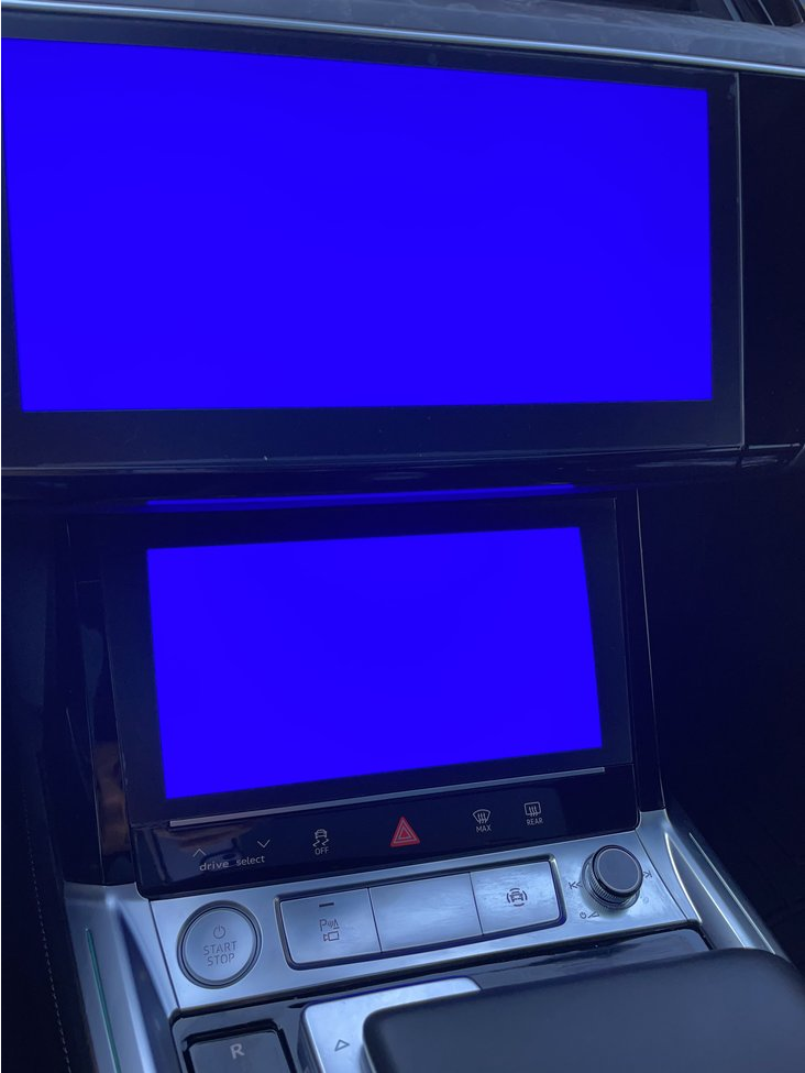

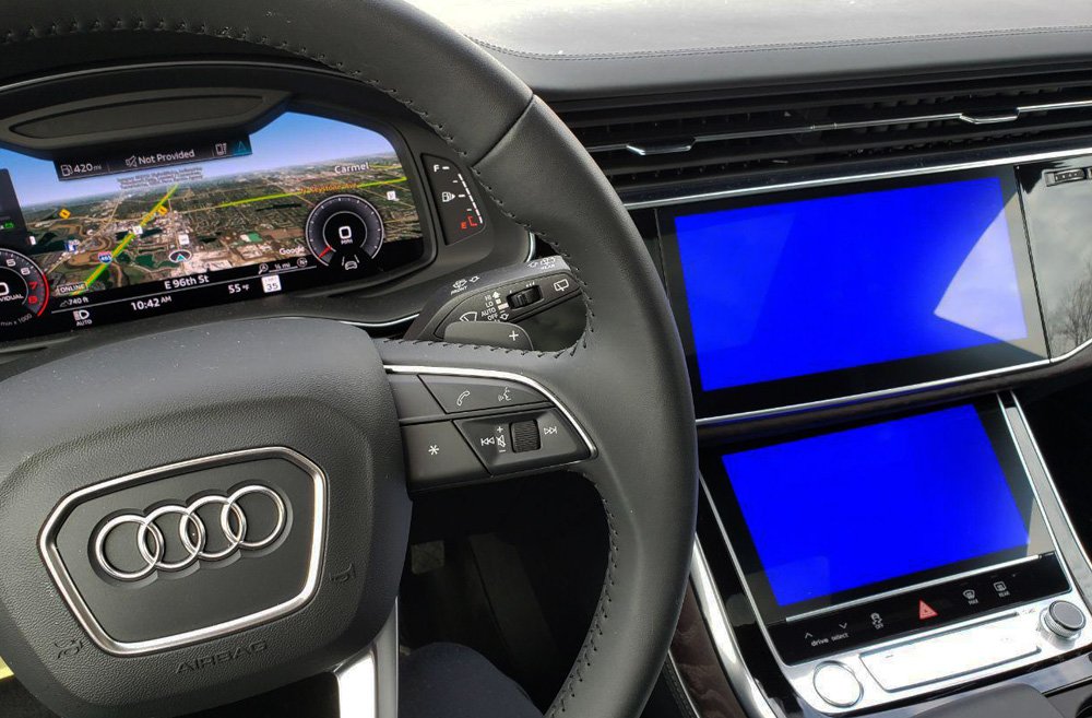

    Screenshot 2022-01-17 at 00-59-49 Audi MMI Reset 1 Simple Step to Unfreeze.png
    Screenshot 2022-01-17 at 01-01-41 Blue screen(s) of death - AudiWorld Forums.png
