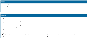

    Ниже коды.На картинках- как провести самодиагностику (придется перевести)
    Коды в куче- таблица расплылась, но разобрать можно
    1111 Faulty ECU. 1231 Speed sensor. 1232 Idle speed motor. 2111 rpm sensor. 2112 Camshaft sensor. 2113 Hall sensor. 2114 Distributor timing fault. 2121 Idle switch. 2122 No rpm signal. 2123 Throttle wide open switch. 2124 Throttle position sensor. 2132 Datalink injection / ignition or faulty ECU. 2141 Knock sensor 1 timing out of range. 2142 Knock sensor 1 no signal. 2143 Knock sensor 2 timing out of range. 2144 Knock sensor 2 no signal. 2212 Throttle position sensor. 2214 Exceeding maximum engine rpm. 2221 Incorrect vacuum signal. 2222 MAP sensor in computer. 2223 Barometric sensor. 2224 Overboost. 2231 Idle speed control. 2232 Mass airflow sensor. 2233 Reference voltage, mass airflow sensor. 2234 Supply voltage. 2242 CO potentiometer. 2312 Coolant temperature sensor. 2314 Link transmission. 2322 Air temperature sensor. 2323 Airflow meter. 2324 Mass airflow meter. 2341 A/F ratio out of range. 2342 Oxygen sensor. 2343 Rich exhaust gas. 2344 Lean exhaust gas. 2411 EGR. 2412 Air temperature sensor. 2413 Lean exhaust gas. 4332 Intermittent connection with actuators. 4343 Canister purge solenoid. 4411 Injector 1. 4412 Injector 2. 4413 Injector 3. 4414 Injector 4. 4421 Injector 5. 4422 Injector 6. 4431 Idle speed control. 4432 Idle speed motor. 4442 Waste gate solenoid. 4443 Canister purge solenoid. 4444 No faults

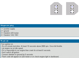

    Пока вставлял картинку-связь пропала.
    Вторая картинка
